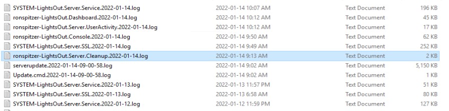

This is a listing of the logs. Which one do you need?

Re: Lights out disappeared from server 2016 essentials
All SYSTEM-LightsOut.Server.Service.2022-01*
All Update.cmd.*
All serverupdate*
Thanks
All Update.cmd.*
All serverupdate*
Thanks

There are no logs for the failed update. The ones shown with todays date are from the manual update I did at 9:02 this morning after downloading it. The only 2 log file from before the update failed is the service log that I sent. I would surmise no logs of the update attempt exist because it did not run the update.
There are SYSTEM-LightsOut.Server.Service.2022-012/13/14 logs. Theses indicate that the service was running and should log the update request.

Sorry for the Delay. I had to do some work for a client. Attached are the system log files as requested. The one from the 14th was created after the manual update to 3.7
