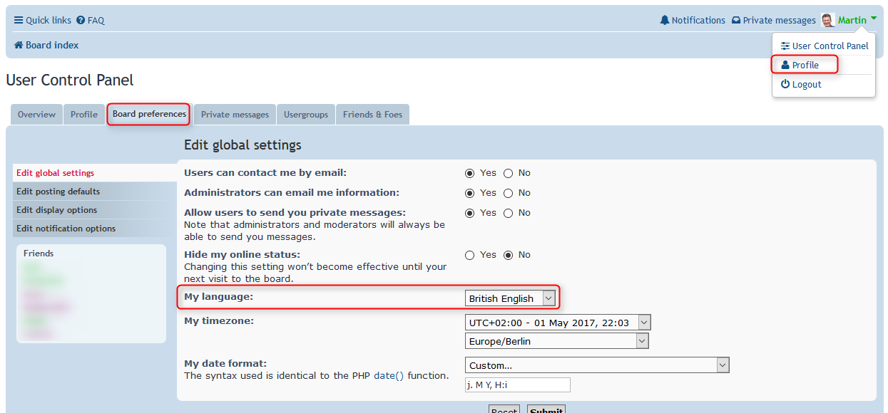

BTW: Have you changed your profile settings to English language?
Re: Client install process no longer automated?
