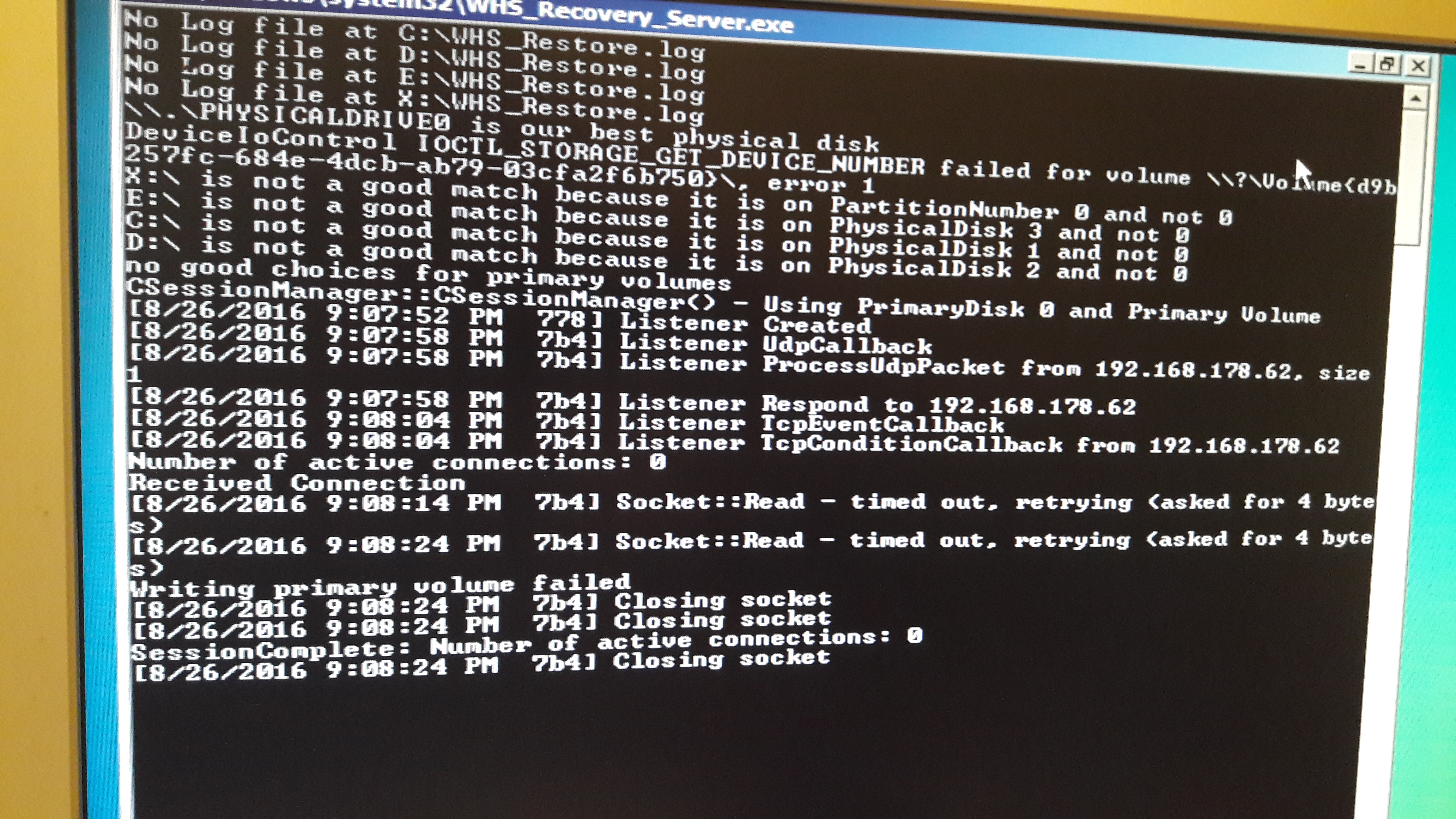

Anbei der Screenshot vom Acer wenn der NetworkError kommt. Hoffe, Du kannst damit was anfangen :nw
"Writing primary volume" klingt schon verdächtig..

Ich kann "writing Primary voilume failed" inzwischen auf meinem Testsystem reproduzieren ... morgen werde ich mal versuchen, mehr herauszufinden

[8/28/2016 10:15:52 AM 618] Listener TcpConditionCallback from 192.168.1.77
Number of active connections: 0
Received Connection
Writing primary volume failed
[8/28/2016 10:15:56 AM 618] Closing socket
SessionComplete: Number of active connections: 0
6. Versuch 20 GB (20480 MB) auf W10 -> klappt nicht
\\.\PHYSICALDRIVE0 is too small in size to be the primary volume
\\.\PHYSICALDRIVE1 is our best physical disk
C:\ is not a good match because it is on PhysicalDisk 0 and not 1
D:\ *IS* a good match because because it is the first partition on disk 1
CSessionManager::CSessionManager() - Using PrimaryDisk 1 and Primary Volume \\?\Volume{86ed8044-6d4d-11e6-9b98-806e6f6e6963}\
[8/28/2016 10:31:16 AM 61c] Listener Created
[8/28/2016 10:31:38 AM 630] Listener UdpCallback
[8/28/2016 10:31:38 AM 630] Listener ProcessUdpPacket from 192.168.1.77, size 1
[8/28/2016 10:31:38 AM 630] Listener Respond to 192.168.1.77
[8/28/2016 10:31:40 AM 630] Listener TcpEventCallback
[8/28/2016 10:31:40 AM 630] Listener TcpConditionCallback from 192.168.1.77
Received Connection
Restoring volume \\?\Volume{86ed8044-6d4d-11e6-9b98-806e6f6e6963}\
Physical location: 1:1
Partition size (21474836480) does not match the file (21476173824)
Volume \\?\Volume{86ed8043-6d4d-11e6-9b98-806e6f6e6963}\ is NOT a good match - (246726144) does not match the file (21476173824)
Volume \\?\Volume{86ed8044-6d4d-11e6-9b98-806e6f6e6963}\ is NOT a good match - (21474836480) does not match the file (21476173824)
DeviceIoControl IOCTL_STORAGE_GET_DEVICE_NUMBER failed for volume \\?\Volume{d9b257fc-684e-4dcb-ab79-03cfa2f6b750}\, error 1
Volume \\?\Volume{d9b257fc-684e-4dcb-ab79-03cfa2f6b750}\ is NOT a good match - (3162112) does not match the file (21476173824)
[8/28/2016 10:31:44 AM 630] Closing socket
Es klappt also NUR wenn eine Partition von 20480 MB unter XP angelegt wird :nw
