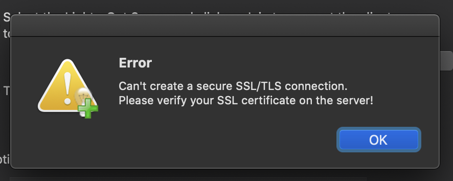

Hi Martin...I can indeed ping the server without ".local" and it is added into domains as again. just "local" without the dot

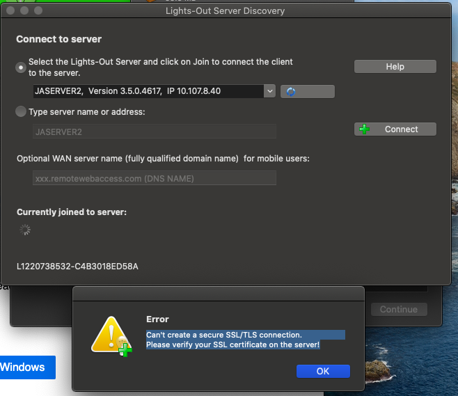

So I try to add a connection to the server using the installation package...if I try selecting the server from the drop-down list...I get eh cert error as below
Screenshot 2020-02-05 at 10.49.48.png (83.84 KiB) 9865 mal betrachtet
so I try again using just the server name and get eh the same response...

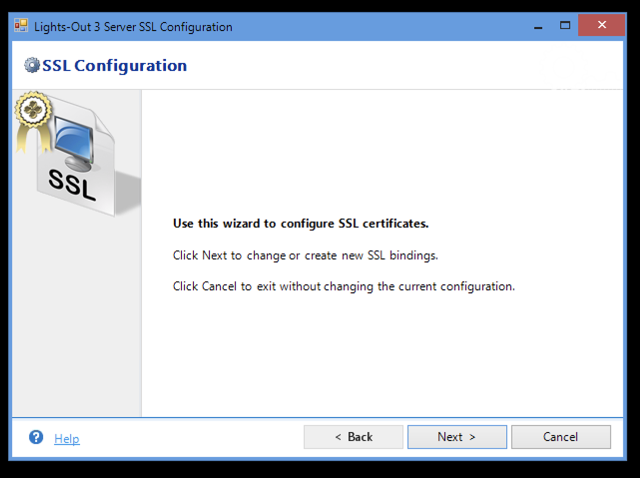

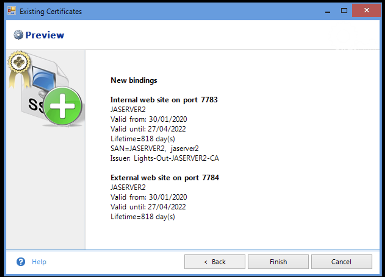

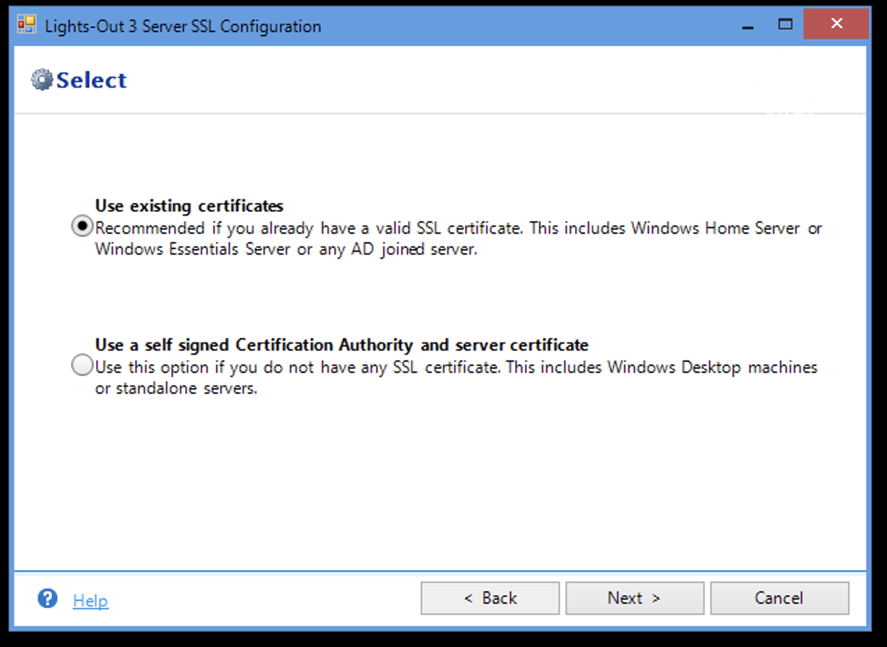

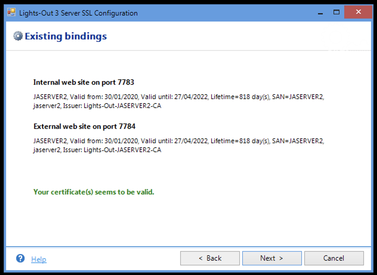

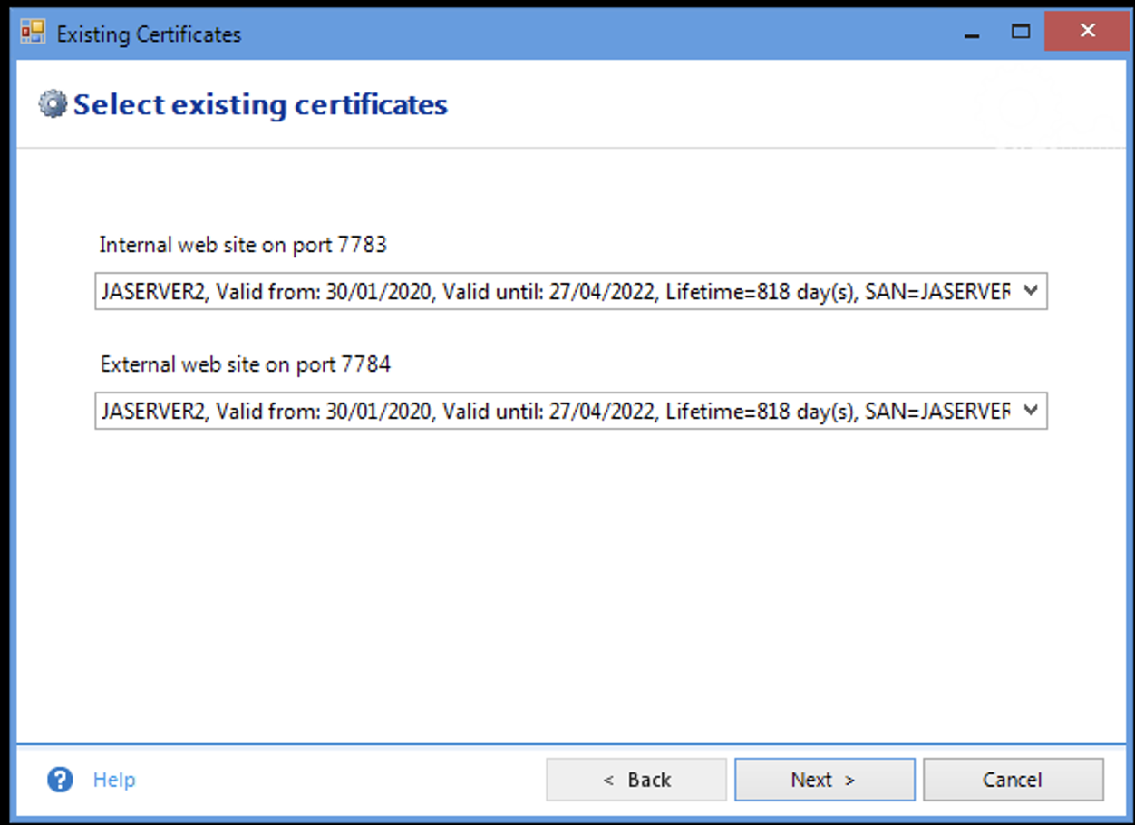

So I log onto the desktop, via Microsoft RDP app for MacOS and connect fine...and go into the cert setup
Screenshot 2020-02-05 at 10.50.29.png (244.46 KiB) 9865 mal betrachtet

then try to reattach server via client and get the same cert error as before attempting both options
Again, this is not an option on Windows and was not an option prior to Catalina.....all windows clients connect without issue...however both of my two MacOS Catalina machines are having the identical issue even though search domains are set correctly...
I fear this could be an issue with MAcOS Catalina as there is also an issue connecting with Synology NAS'. If the synologyNASname.local is used they work fine...BUT even with local added as a search doman...ti is not possible to ping or connect to the Synology NAS without.local after the server name

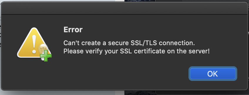

however, when trying to add the server via the client... I still get the same issue re certs.
Screenshot 2020-02-06 at 16.36.33.png (72.43 KiB) 9806 mal betrachtet
to be thorough..and not waste more of your time... I tried it with the server name in lowercase and uppercase..(cert setup on the server itself lists them in uppercase) but it makes no difference either way

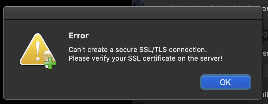

Re: Can't login to server during MacOS Client setup
Verfasst: 12. Feb 2020, 15:01
von jandrews74
still no joy I'm afraid... the same response as before after following your steps
Cant create a secure SSL/TLS connection
Please verify your SSL certificate on the server
I've attached a screen grab again and also zipped up the logs an sent the m in a PM

The logs are still missing the important part of the server join.
Can you please verify twice, that you zip the folder /var/log/lights-out-client and not individual files?
