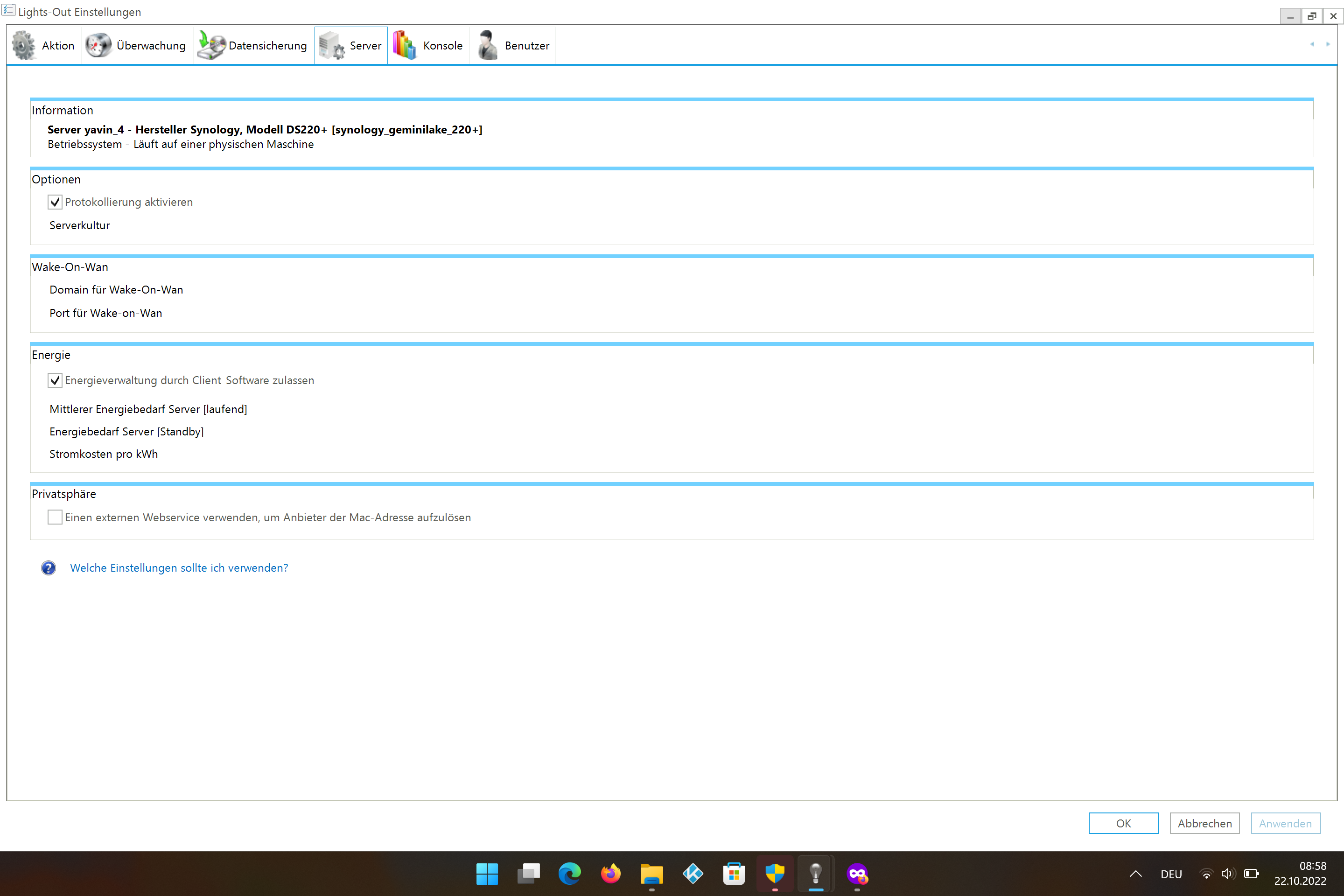

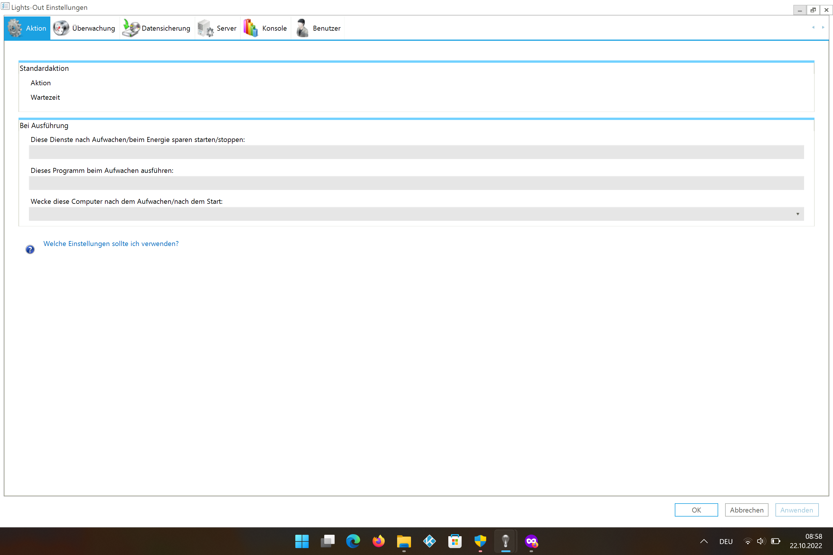

Hi there,
I have been a happy lights-out 1 user for several years now. Since the service for WHS v1 is discontinued for Windows 11 machines, I thought it was time to think about alternatives for the old chap (WHS v1 that is).
So I now try NAS, a DS220+ DSM7 Synology to be exact.
First thing I did was trying a lights-out install (so the NAS is still blank), but I encountered a problem I can not find a solution anywhere up to this point. Here is what I did so far:
I installed lights-out 3.7.2.4869 and followed your workaround step by step.
On the DS220+, everything worked fine so I started console installation via the provided download-link.
Again, everthing went worked fine including client software, no errors reported.
However, there seems to be something wrong with the settings menu. For one, there is no option/field shown for standard action (neither action nor time) and in "server" I can not choose any energy option (see screenshots).
Did I miss a setting before? Is a permission missing somewhere? Any idea?

Re: Lights-Out on DSM 7
Indeed, that looks strange.
Please collect the Synology logs, see here https://help.green-it-software.com/help ... gyNAS.html
Next collect the logs from the console: Simply zip the whole folder c:\programdata\LightsOut3\Logs (via right click, send to compressed folder) and attach the archive to the ticket. If you do not see a folder c:\programdata, then open explorer options and enable "show hidden files and folders".
Send both zip archives to support [at] gren-it-software dot com
Thanks
However, when I look at the screenshots, could it be that the elements on the right are outside?
What is the scaling of the screen?
Yes, that's the case (verified).
I will publish an update. Thanks for reporting!
Regards
Please manually install this test version:
https://www.green-it-software.com/downl ... a-dsm7.spk
Then apply the workaround. Then update the console.
Regards
Judge
Beiträge: 5
Registriert: 22. Okt 2022, 08:19
Beitrag von Judge »
Hi Martin,
Came back from holiday yesterday, sorry for the delay.
The new version fixes the problem, everything is running smoothly.
Thank you
